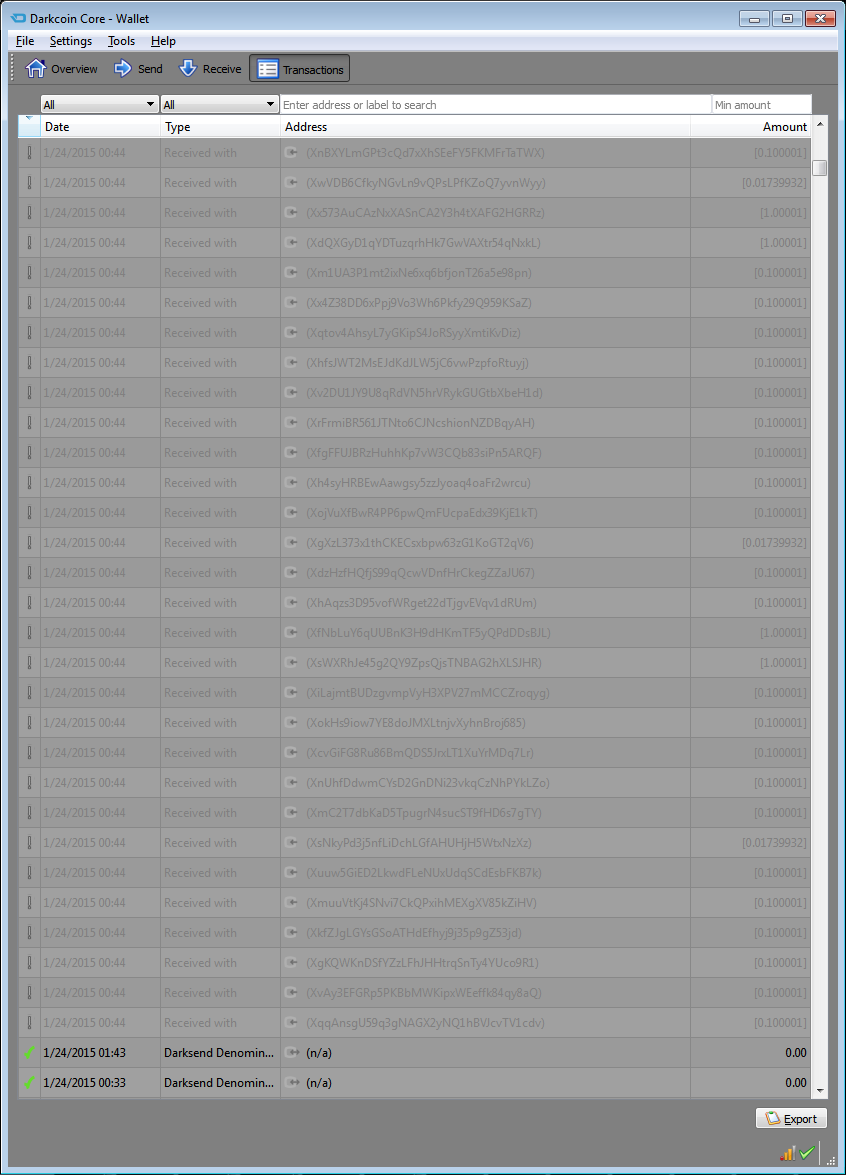

Windows 32-bit, v.110013. Just got a weird stream of DS tx's back on my Transaction screen, not sure what this means:
