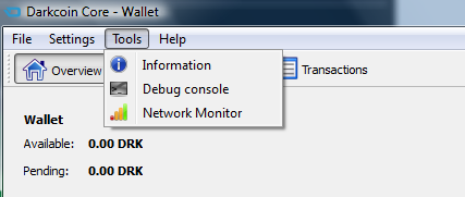

Nice Tools menu in this version where to find the Debug console:

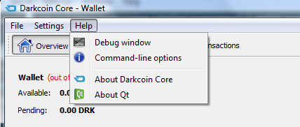

In previous versions before v.110011:
