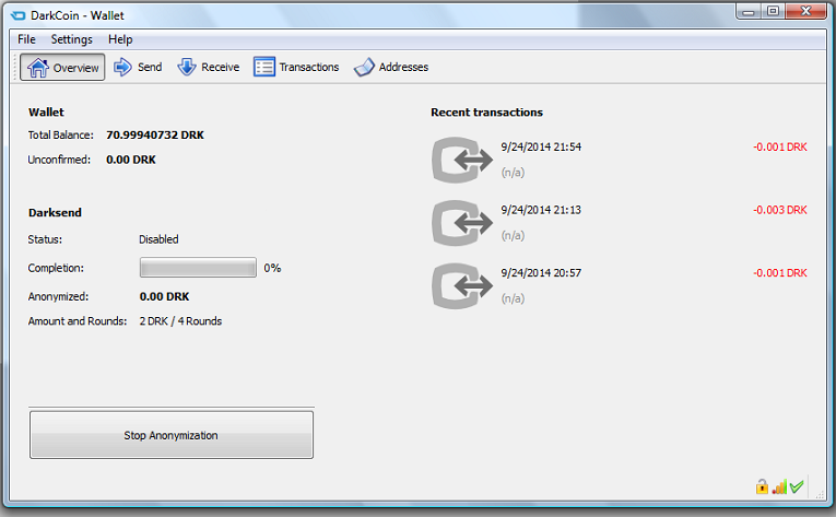

I think you're right, there must be a bug in anonymizing small amounts and so far we know anonymizing only 2 drk is not possible, as you saw last night in the IRC channel what we did. I'm just reporting here to let the devs and everyone know. Another participant with 2 clients and I tried to anonymize 2 DRK.
All 3 clients had the same settings: 2 DRK to keep anonymized, 4 rounds.
Here's the result - The other participant said:
[22:33:44] <shlermb> both fresh, both sent 2drk, both set 2drk/4rnds. now show balance: 1.9865, completion: 100%, coin control shows 1drk having 1 round.
[22:33:55] <shlermb> anonymized: 0
At first , my wallet received 1 "Payment to yourself" fee... Then the waiting... After a while Darksend Status said "Disabled", BUT the "Start/Stop" button said "Stop Anonymization", meaning that DS was still on and the anonymization was still going!! Then I clicked on the button, it did not change one way or another, like it was being froze, (Windows wallet, v.10.13.15). I then had to exit the wallet and restarted it. The wallet seemed back to normal, the "Start/Stop" button seemed normal again. I clicked on the button to start DS again, but it did not do anything, still no Denominate fee ever happened, and 0 anon DRK. I saved the screenshot of my wallet:

I think newbies are wanting to know how DS works and they start out with just a few Darkcoins, and when they try to anonymize 2 or 3 drk but it doesn't happen, they might think this doesn't work. :sad:

That was precisely my logic and why I submitted JIRA 90 as well as personally emailed Evan about it.
Hopefully, eduffield or flare will have time to look into this. :smile:
Maybe moli can comment about this to DRK-90 or make new issue (better, gets more attention).
My opinion about this 'small amount wont denominate and anonymize' is:
it is critical for Darkcoin, because new and average users will test with small amount first,
and because it wont work, DRK:s reputation and user experience is negative.
I tried twice to anonymize using only 2 coins, just to see how the process works, and concluded , "It doesn't".
Maybe a message warning users "You may only anonymize minimum of x coins" to avoid such misconceptions.
