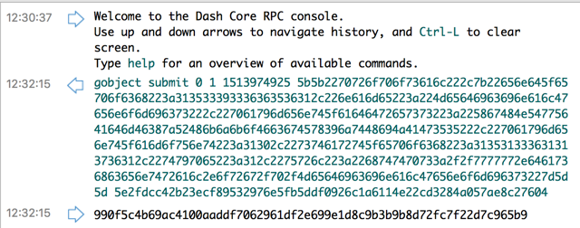

Anyone know how to get past the payment side of the Create Proposal
Sent the 5 DASH,
received this transaction ID but the page wont advance?
5e2fdcc42b23ecf89532976e5fb5ddf0926c1a6114e22cd3284a057ae8c27604-000
16:39:28
cmd-request
gobject prepare 0 1 1513974925 5b5b2270726f706f73616c222c7b22656e645f65706f6368223a313533393336363536312c226e616d65223a224d65646963696e616c47656e6f6d696373222c227061796d656e745f61646472657373223a225867484e54775641646d46387a52486b6a6b6f4663674578396a7448694a41473535222c227061796d656e745f616d6f756e74223a31302c2273746172745f65706f6368223a313531333631313736312c2274797065223a312c2275726c223a2268747470733a2f2f7777772e6461736863656e7472616c2e6f72672f702f4d65646963696e616c47656e6f6d696373227d5d5d
16:39:28
cmd-reply
Added a screen grab to make the missing images appear.
Many thanks to @coingun and @babygiraffe for weeding this out:)
https://www.dashninja.pl/proposalde...df7062961df2e699e1d8c9b3b9b8d72fc7f22d7c965b9
I believe the URL for this proposal on DashCentral is still down. Until then I will point links to this site in a few other places.
To vote from dash-qt (graphical wallet), go to Tools > Debug console and type:
gobject vote-many 990f5c4b69ac4100aaddf7062961df2e699e1d8c9b3b9b8d72fc7f22d7c965b9 funding yes
dash-cli gobject vote-many 990f5c4b69ac4100aaddf7062961df2e699e1d8c9b3b9b8d72fc7f22d7c965b9 funding yes
Not obsolete. Helpful video as it made me realize her webpage was different than what I was using and got some help from babygirrafe. Pointed me to the site above. The tricky part is that my 5 DASH transaction went through but the process stalled out before the Submit function completed. I wouldn't point anyone to this site https://www.dashcentral.org/budget/create
As it hangs and is non-responsive for many parts of the submission process. Still waiting on the proposal to show up on the proposal board? Thank you for your help
Dashcentral is back up and working well.
For others that read this- see below for a FAQ That explains this gobject submit process and makes it less stressful once your 5 DASH leave your hands. RTFM still applies;)
