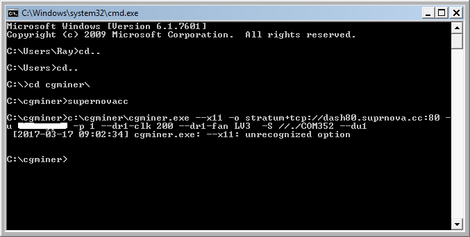

I have my batch file created for supernovacc, drivers installed and the miner is recognized, but I'm getting the attached error.
Can anyone point this newb in the right direction?
Thanks
Thanks
1) Is this cgminer right version, downloaded from github?
2) You must change COM352 to yours (check Windows Device Manager for COMx devices).
1) Is this cgminer right version, downloaded from ?
Thanks! I actually just downloaded the right rev, and will change the com port to the corresponding one!
