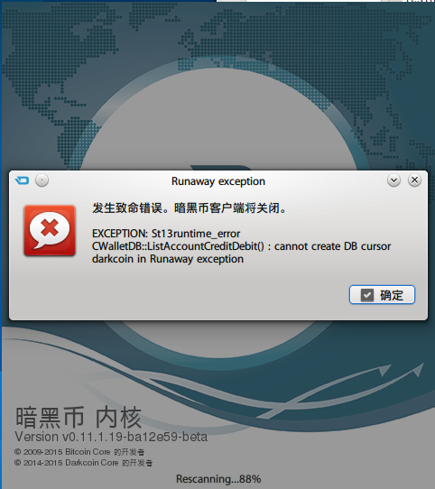

In loading splash screen, there is a rescanning showed, it's very slow compared with other wallets. And when it get to 88%, it's crashed and through out an error:View attachment 991

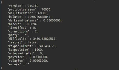

But this wallet works with "darkcoind"....
OS: Ubuntu 12.04 LTS 64
Darkcoin version: V11.1.19 linux
working screen shot with darkcoind:View attachment 992
And i've tried this wallet with many historical backup version. All of them failed with QT.
EDIT:
use -reindex -zapwallettxes as parameters. It works!!
Thanks guys that mention it.
