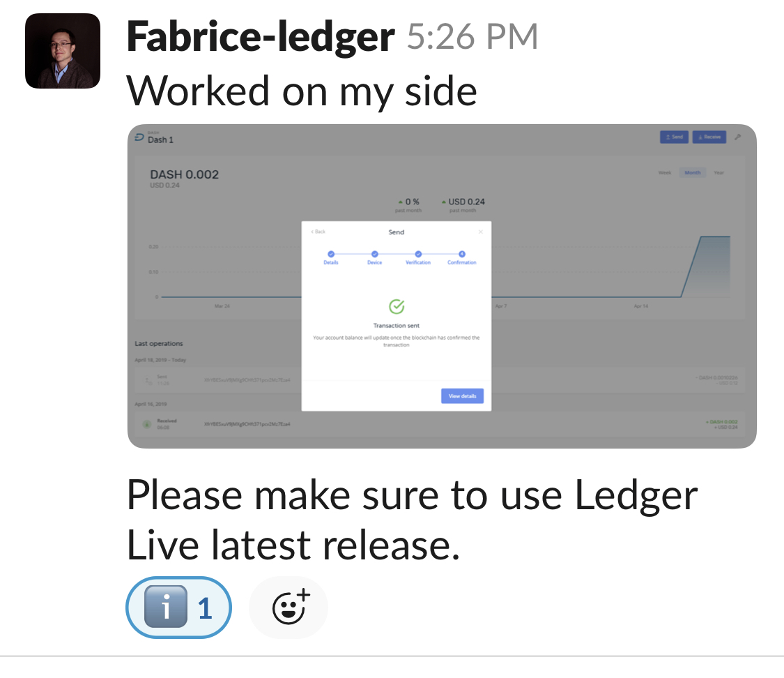

Could you please give them another ping on Slack with this info ... i will update the reddit thread.
I can tell Ledger was working on it as i got a little bit further with the transaction process itself, but in the end Ledger Live gives above failure message
(which again shows "Missing inputs").

update:
all looks fine on their side, i send them some dust to double check
i keep thbis thread posted
