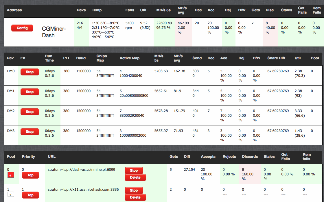

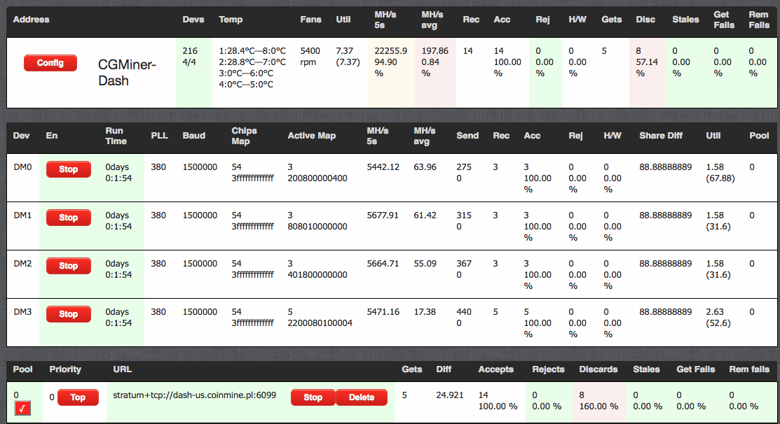

Hi,
Having some issues with 2 new DM22Gs. Have 1 DM11G that's been pretty steady.
Firmware upgrade help.
The DM22Gs arrived 4-5 days ago. They have firmware cgminer-IB3.6.2 currently. I understand 3.6.5 is the latest, but neither will update from the control panel / config when I enable the checkmark next to update and the hit the update button. The unit restarts, but it doesn't seem like firmware was downloaded and it continues to show 3.6.2. Am I missing a step for firmware upgrade from the control panel? The DM11G updated fine from the control panel in the past. I'm hoping to avoid manually flashing the TF cards if possible.
Hashrate help
If I work at it (multiple restarts) I can get both machines to show MH/s 5s in the 22GH range, but the MH/s avg can be really low, usually below 500 MH/s. Results at the mining pool are showing poor performance.
One of the two DM22Gs will rally and the MH/s avg will rise to 18-23GH and produce acceptable pool results. The other never does. Temps are around 30c for both units. Chip Map shows 54 across the board (all 4 blades, both units), Active Map is mixed with values ranging from 5-13 across all blades.
I'll try to attach two screenshots of the control panels for each unit and a 3rd showing the firmware version (same for both). Any advice on improving parameters for the pool are welcome.

Hi Steve,
Firmware Upgrade
You are doing the correct steps to update the firmware, check the box next to Update and hit the Update button. I am not sure why the upgrade is failing, I will have to check with the software team about that. I know you probably want to avoid physically opening the miner but I wonder if the TF card is not seated correctly or if the write lock was accidentally set on the card. You many need to manually update in the meantime.
Also, I noticed that not all the temperatures seem to be showing. You will need to check the temperature DIP switch settings to see if they are correct. They are located on hashing boards 1 and 5 on each blade, the number setting are on the panel board (see pictures). If everything was set correctly, then it may be a sign that there is an issue with the TF card or the image.
Hashrate Help
When you check the MH/s 5s and MH/s avg, do you remember how long the miner was already on? The MH/s avg will take a while to show a realistic hashrate since it is the average over the total time the miner is on. That means the longer it is on the average will be closer to how it is actually performing.
Please try to update the firmware and then test the pools again, it could be something has changed that is affecting the hashrate.

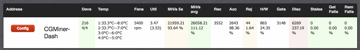

Thanks for the helpful reply.
I went ahead and manually flashed one of the DM22Gs last night. The process went fine, just a bit slow as I'm using VMware Fusion on a Mac to run Windows 10 in order to run the flashing SW.
After the flash, the unit running 3.6.5 got more stable and all temperature sensors started displaying in the control panel. The unit running 3.6.2 is hashing fine, but the temp sensors are not showing results that make total sense. I'll attach a pic. I plan to flash this unit as well soon.
Questions:
  1. Is there a way to save the pool config and reload it after the flash? It can be cumbersome to re-enter all of the pools and settings.
  2. Would it be possible to duplicate a working TF card (has the latest, has the settings already done) for use in other units? I have more DM22Gs to flash. I'm worried that it might duplicate hostname and other items which would be problematic. It could save me a fair bit of setup time if there's a way to duplicate a working TF card properly.
You asked about how long the miner was on when the images were taken. Both show uptimes for the blades of under a couple of minutes. But I had been seeing these sorts of extreme differences in MH/s/5s and MH/s avg with the one box after it had been running for hours. That got my attention, along with the different behavior when compared to the DM11G which seems to even those numbers out fairly quickly.
I will try running them on a variety of pools as I can. Still trying to find the setup that produces the best profit for my situation.
Here's a pic of the temps shown in my DM22G that's still running 3.6.2. Sensors 1 and 2 show a reasonable 1st temp but odd numbers for 2nd temps (8c and 7c). Sensors 3 and 4 show temps of 0c-6c and 0c-5c. Hopefully the firmware update will solve this.

For the temperature readings, you are a little bit wrong in how you read what is shown. It is a bit confusing at first.
The 4 rows represent the 4 blades in the machine. Blade 1 has temperature sensors 1 and 8, Blade 2 has temperature 2 and 7, etc.
So actually Blade 1 is showing temp sensor 1 with 33.3C and temp sensor 8 with 0C. Blade 2 is showing temp sensor 2 with 33.7C and temp sensor 7 with 0C, and Blade 3 and 4 displaying all 0C.
I believe what is causing this display issue is because firmware IB3.6.2 is using the same code from the DM11G, where the temp are averaged into 2 temperatures to be shown. In IB3.6.5, this display issue is fixed so actual temps on each blade is shown.
