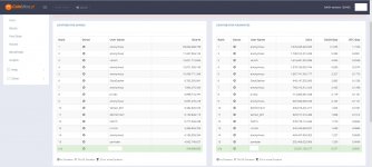

Here are the results of coinmine.pl as well not good
have a look
PLL also 600 and temp under control.
Please resolve this or issue me refund as i paid for 11 Ghs miner and not 8/9 Ghs miner.

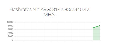

I have tried out granatgas pool and here are the results after roughly 24hrs or so. I have not set any other parameters in the password field besides c=dash. I thought I would share this result with you guys.
