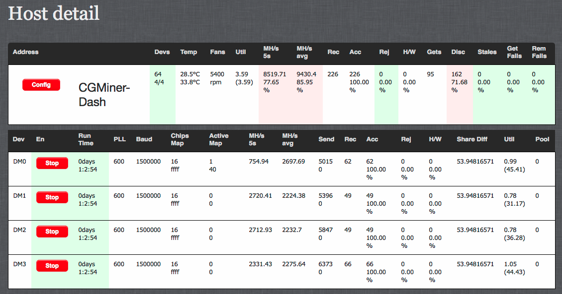

I could use some help analyzing the current control panel.
I'm sometimes seeing the Active Map show very low numbers for most or all blades. In the pic I'm sharing it's almost 0 across all blades.
Hashrate is sometimes OK, but often low, both on the control panel at at the mining pool.
Temps are reasonable, H/W seems fine. I restarted about an hour ago for the same reason, hoping to see things improve.
I'm not seeing anything obvious. Any ideas?
Hi,
It is related to the Share Diff. At higher Share Diff, the Active Map will show low numbers while on a lower Share Diff, it will show all 16. It's just how it delegates work.
