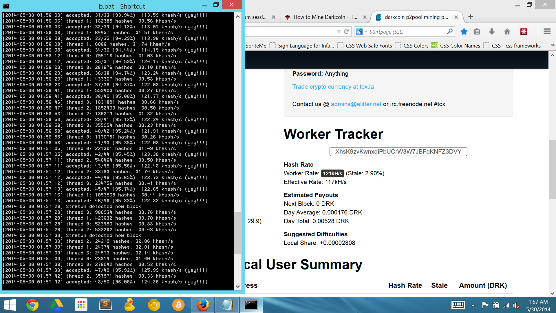

update: i let it go back to giving my difficulty level which is much lower than 1. it's like .022 getting false positives again but wasn't getting any work at all at 1.
matching my recommended local share has given me these results:
