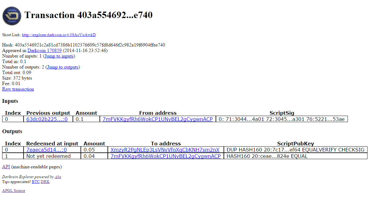

Explorer don't show multisig addresses

Hmm, something is not working, this is supposed to be a multisig address, which is supported by latest upstream.
Well, if I understand how Abe works, it loads the config to a table on first start.I know where to update the prefix for public keys but not for multisig..
update chain set chain_script_addr_vers=unhex('10') where chain_name='Darkcoin';
