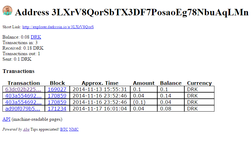

I have been playing with multisig the last couple of days and I've seen that only cryptoID recognizes multisig addresses.
The multisig I created:
3LXrV8QorSbTX3DF7PosaoEg78NbuAqLMn
In cryptoID is shows perfectly:
https://chainz.cryptoid.info/drk/address.dws?3LXrV8QorSbTX3DF7PosaoEg78NbuAqLMn.htm
In all the other explorers, including the official one, I get 'Address not seen on the network.'
When I check a transaction with a multisig address involved cryptoID shows it as any other:
https://chainz.cryptoid.info/drk/tx.dws?668723.htm
But the official one shows 'unknown' instead of the multisig address:
http://explorer.darkcoin.io/tx/403a5546921c2a81cd7386b1102376609c57fd8d646f2c982a19f6904ffee740
Please post when you've done the update :)
Seems to work - will deploy to live server after further tests.
