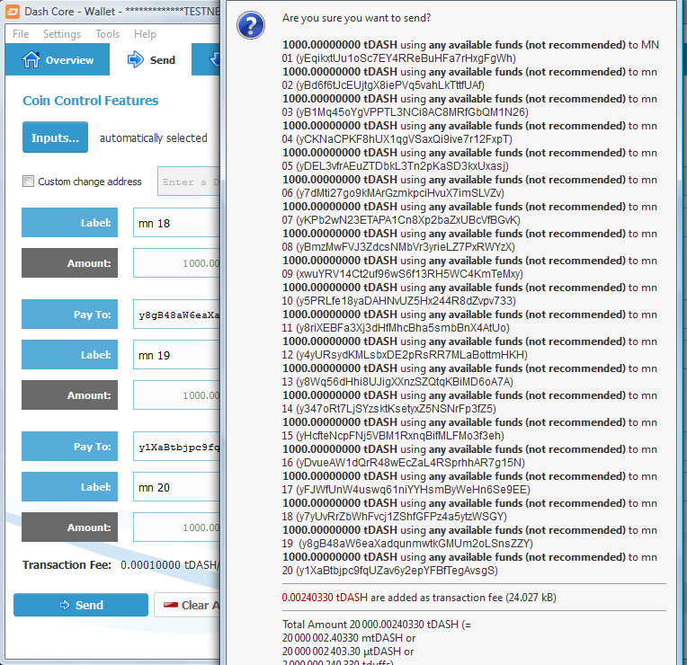

Hello...
I'm trying to make a transaction with 20 inputs on Testnet... but I can't send because the "Confirm send coins" screen is really long and can't be resized so I can get to the "YES" button at the bottom. I've tried to move it around, pushed it all way to the top of my computer screen so I could see the button but it can't happen... Is this my screen problem or is it the wallet? I wish the "Confirm..." screen could be resized though.
EDIT: Just deleted one payment and now the screen lets me see the "YES" button so i can send this transaction.
Hello...
I'm trying to make a transaction with 20 inputs on Testnet... but I can't send because the "Confirm send coins" screen is really long and can't be resized so I can get to the "OK" button at the bottom. I've tried to move it around, pushed it all way to the top of my computer screen so I could see the OK button but it can't happen... Is this my screen problem or is it the wallet? I wish the "Confirm..." screen could be resized though.
Any window should not never grow bigger than screen resolution, like this example.
So, there is not any check resolution function i believe.
Code (Dash program) should check window size and screen resolution, and keep window max size same as screen resolution.
Ah.. I agree.. Thanks. So I guess it's not my problem but dash's problem.. lol
