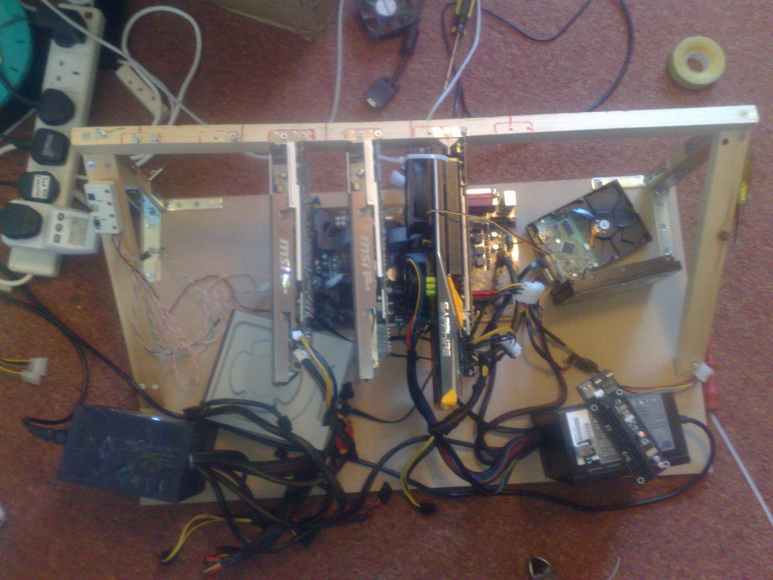

here, little surprise for you, I did a couple of pictures for laughs on the new wood backed computer.
One of the R9 290 triX fans has been driving me crazy for weeks with it's squeaking and rattling, so I finally ripped it out and used an old cpu fan, making that 2 out of 3 now!
End result :- it runs silent, tickover is actually cooler, saved $30 on replacement fans, and most importantly there is virtually no noise, :cool:
Half finished H81 mining motherboard and (discarded) parallel PSUs.
