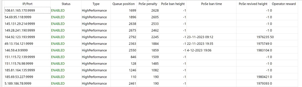

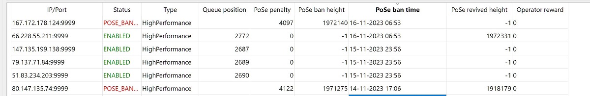

Evonodes that got PoSe banned these last few days : filtered on PoSe ban time
Source : Dash Masternode Tool

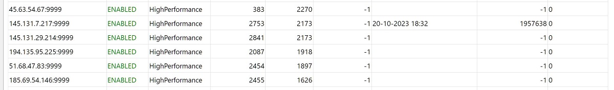

Evonodes that got poSe penalty scored (i assume recently) : filtered on PoSe penalty
This should not occur on such low number of Evonodes (88) and it does seem related to the release of Dash Core v20 / use of Dashmate.

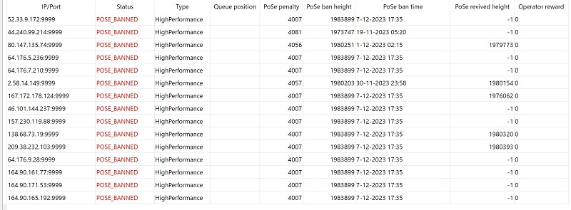

Filter on PoSe Banned

I noticed the same thing, evonodes seem to be quicker to get a score and even banned, for instance, many of those above nodes that were banned got 2 scores within minutes of each other leaving the MNOs no time to react to the first score, which I believe is the intent. It might be to do with the much smaller pool of evonodes compared to the regular nodes, still it is pretty brutal for the eMNOs.
Yeah; this is likely due to the higher utilization of Masternodes since the rotated LLMQs introduced in v19. If you happen to be in two LLMQs at the same time and shutdown your node at a bad time you'll basically get insta-Pose banned
Should we perhaps account for this by lowering the rather high 66% DKG session failure PoSe score to 50%, so Evonodes can survive two LLMQ hits at the same time and have less to worry about during a Core update ? (when dashd needs to be briefly shutdown)
