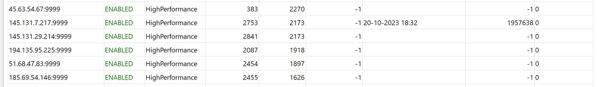

Evonodes that got PoSe banned these last few days : filtered on PoSe ban time
Source : Dash Masternode Tool
Evonodes that got poSe penalty scored (i assume recently) : filtered on PoSe penalty
This should not occur on such low number of Evonodes (88) and it does seem related to the release of Dash Core v20 / use of Dashmate.
