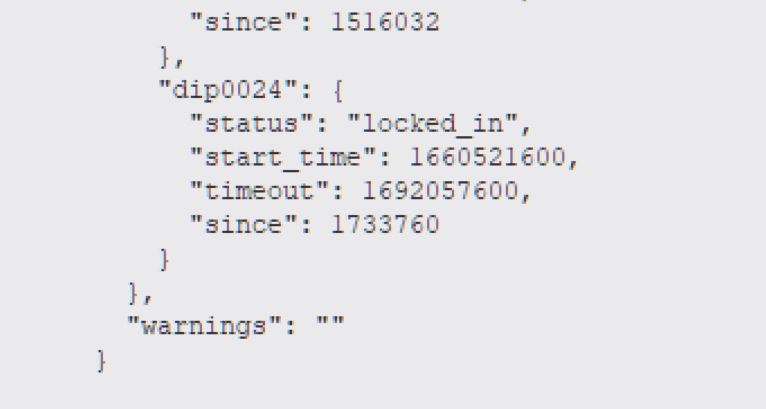

Looks like DIP24 (Quorum Rotation) locked-in, despite below drop in percentage of Dash v18.0 blocks found by miners (currently below trigger of 80%).
DIP24 should be fully activated at block 1737792 / 13 Sep 2022.
Please someone correct me, if i am wrong....

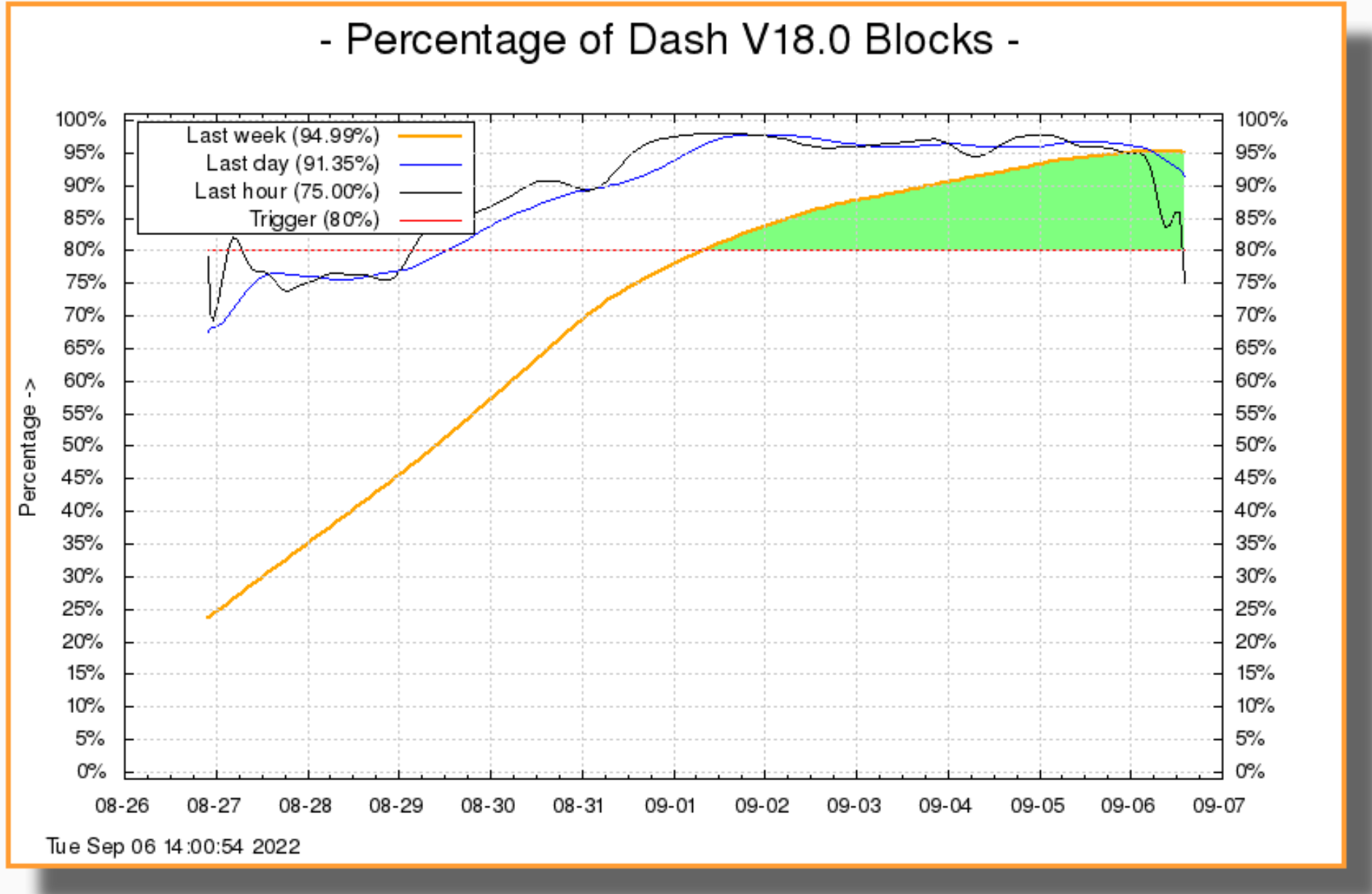

You are correct! We locked in with a staggering 95% of miners signalling for the hard fork! I think that might be a record.
We now wait for 4032 blocks, about 7.35 days for the hard fork to activate on block 1737792, which is about 13th of September depending on your TZ.
And we have 88.5% of the Masternode upgraded, the rest will either upgrade in time or simply be forked off the block following the fork.
And how do you explain the drop in the percentage of the miners?
Is there any other reasonable explanation, apart from the "agents conspiracy theory"?

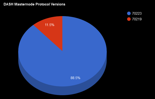

Is it just a coincidence that the percentage of the miners started falling below 80%, when the masternodes reached 80%?
The charts Qwizzie posts are inferior, that is why I always delete them, I only trust mnowatch as the source, there was no drop in miner signalling, it was a strong finish, perfect actually. I am surprised we locked in so soon, I was expecting it to take at least another month.
In what chart of mnowatch.org can we see that there was no drop in miner signalling?
The actual data is in the blockchain so it can be reviewed directly there. But this is my snapshot from every 15 minutes showing the number of blocks signaling in the window ("Count" column): https://keybase.pub/thephez/dash-18.0.1/dash-18-miner-update-progress.csv. You can see it charted here: https://docs.google.com/spreadsheet...03vCw2r9h5KyXR7FTyyIgmoVRg/edit#gid=452706455.
I don't see any substantial change in signaling near lock-in. In fact, all the miners could have stopped signaling the last day and it still would have locked-in because the threshold had already been achieved. The Dash_info chart can be a little misleading because it doesn't factor in the signaling windows.
