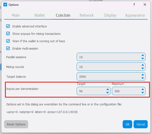

Hello I found a way to do this with the dash.conf file using
coinjoindenomshardcap
and
coinjoindenomsgoal
Now I now longer have 50+ tiny denoms

That's a good hint, yes I am aware of those options, but never had good success with it, could you post the exact lines required for dash.conf to target only large denoms?
Hi, I understand these 2 parameters have been added to the GUI (-coinjoindenomsgoal -coinjoindenomshardcap), are there any cases about their optimal use, and cases where this is directly needed? Thanks
