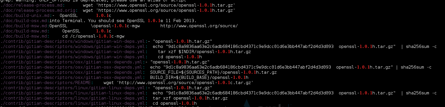

can you explain how to fix this? I just merged upstream and this is what I can find:
only references to c, e and h but not j. what do I have to do to fix this?
Change the files to j and update the sha256 from the files. You can get the tarball from the official OpenSSL website.
Download the OpenSSL-archive (same link, just replace "h" with "j"), copy it to the input folder, change the references in the 3 *dep*.yml files from "h" to "j", and update the sha256sum with the one of the new OpenSSL-archive in those 3 files.
That's all.
Edit: elbereth beat me to it. Anyway, better 2 answers than none :smile:
