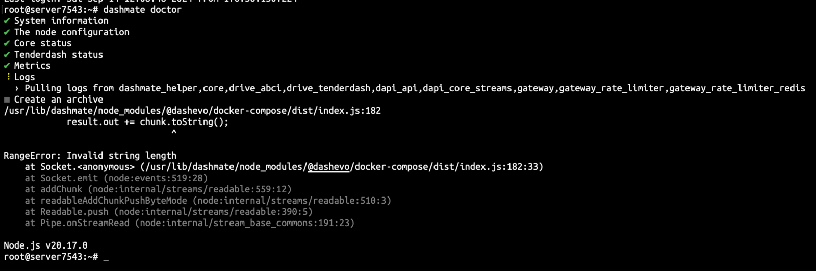

Use dashmate doctor command to generate a report and send it over to [email protected] so they can investigate.
Explain your issue to them. Include also above ERROR from your Docker Tenderdash container log.
Is it possible to reset dashmate without resetting the blockchain?
The commands i provided to you before will reset dashmate without deleting the L1 blockchain.
Pls send an email to [email protected] describing your issue and include the log of your Tenderdash file. Explain to them that dashmate doctor command gives error. Good luck.
