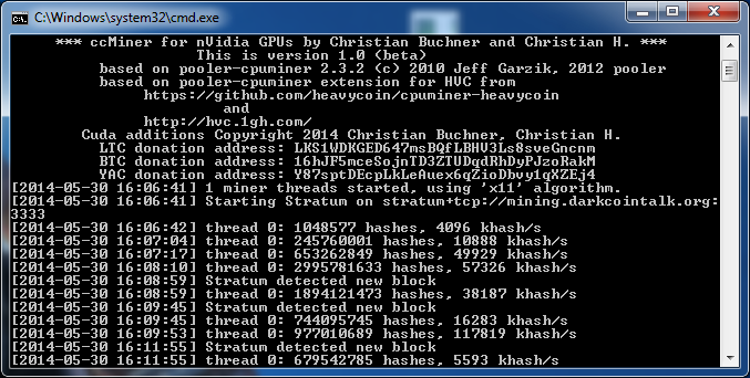

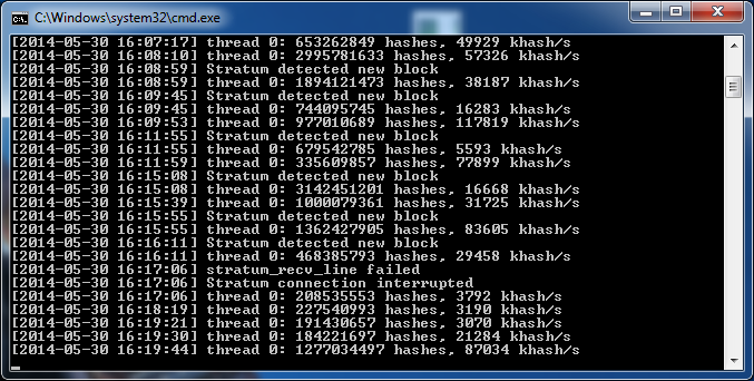

I'm not erroring out, I'm just not finding any blocks or hashes because it doesn't seem to actually connect my userid to the pool server. So with CPUminer I can see my two workers are connected to drkpool. I can see from drkpool and cpuminer when they find valid shares. It was the same when I mined bitcoins. When I run ccminer## (any of the number'd ones) they work and process hashes as you can see from the included screenshots but drkpool (and darkcointalk) do not acknowledge the worker's ID and the program gives no indication of finding hashes.

First, what Nvidia card do you have? The ccminer(30,35,50) refers to the version of CUDA. Such as, my GTS 450 only supports up to 2.1 while Syntor's GTX 760's support CUDA 3.0 (And oddly enough, the GTX 750's support CUDA 5.0....how does that work?)
Second: https://developer.nvidia.com/cuda-gpus
The link above is a reference list of what version of CUDA each of their cards is compatible with.
If for some reason, your card is only compatible with CUDA 2.1, go here: https://github.com/KBomba/ccminer-KBomba/releases/
It has the older CCminer21 that I don't believe is really supported anymore. Good luck, I hope this helps!
