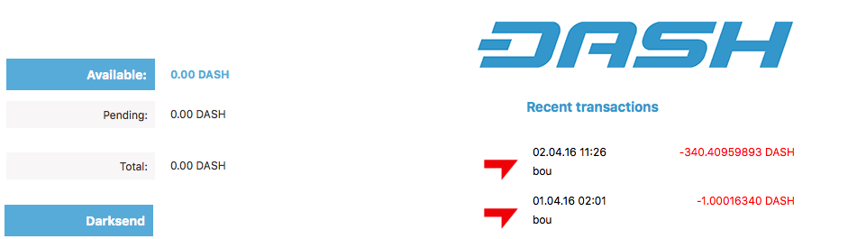

Cool! Here is the rest of it http://explorer.dash.org/tx/7f6e5aa8b83f80f54c3c37c9999c0ed856357caaef72ac42bc8022a338643dac
