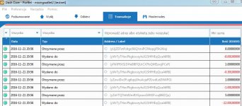

I have setup a service for InstantSend https://test.stats.dash.org/is/
Send X tDash to address in page using InstantSend, will get Y tDash using InstantSend.
(Normal tx will get Y tDash after 6 confirmation)
Send X tDash to yWrTyTHavPkgboceyhzX1SHfHEqQcaA6R8 using InstantSend, will get Y tDash using InstantSend.

Works like a charm...
Yep works smooth ;)
