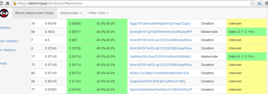

Also, just in case someone is wondering why there're so many yellow "Unknown" blocks on https://dashninja.pl/blocks.html#perminer, like this:
elbereth explained to me that:
[12:30:09] <elberethzone> when there is a donation there is not way to know which masternode was elected
[12:30:19] <elberethzone> (unless there is only one donating to that address)
[12:30:37] <elberethzone> so there is no way to know the masternode version, hence "unknown"
