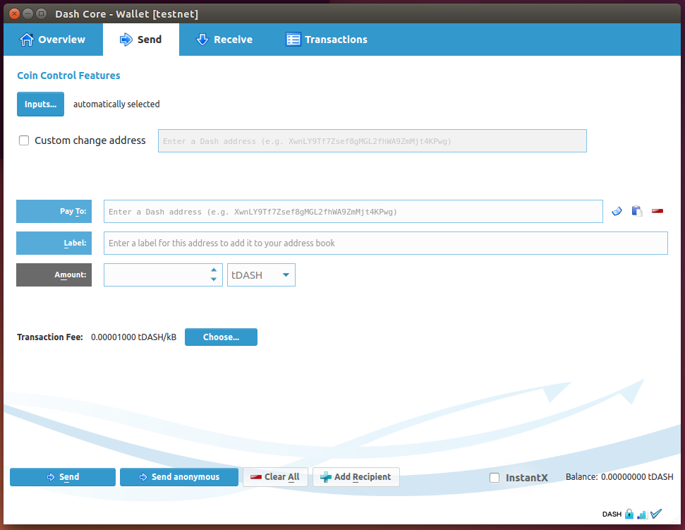

3 screens would be way over the top...coincidentally I already thought about this problem some moons ago and decided that getting rid of the "Darksend" checkbox and using 2 dedicated "Send" buttons would be the most convenient way to implement this.
Looked like this:
Not yet ready for upload, have to complete other things first...

So cool! I forgot that InstantX can be either with DS or no DS.
Now we need only two holes instead of 3 for the cats! Thanks! :grin:

Then there should be two balance, normal and anonymous balance, right?

AjM's post got me thinking.. In the past we had 3 balances: Anonymous (DS), Non-Anonymous, and No Preference. Then Evan got rid of one of the balances and now we've been having only two balances: DS Only, and Total Balance. To send a "Non-Anonymous" tx, unless you know how to tick the boxes in the Coin Control to send only "No DS funds", your transaction can be a combination of DS and non-DS funds, which can de-anonymize your transaction, unless you don't care about it.
Could you also create an option for us that we can choose "Only Non-Anonymous" transaction without having to go to the Coin Control. I think this also solves camosoul's question on his thread. Also, if the wallet could calculate the fees right there on the Send screen before we press the button "Send", it would be awesome.... Thanks! :)
