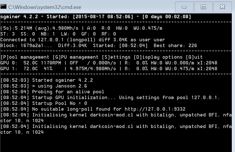

Flare and Paws, I do not have Nvidia but this solo mining works with sgminer but only with V11, it looks like your rpc port setting is wrong, put this as your dash config, then rerun Dash V11,wait sync and keep running.
(btw, this does NOT work in testnet for me, and does NOT work with V12 because I just tried it!)
rpcuser=user
rpcpassword=x
rpcallowip=127.0.0.1
rpcport=9332
daemon=1
server=1
goto your sgminer equivalent mining GPU folder and use something like this,
sgminer -k darkcoin-mod -o 127.0.0.1:9332 -u user -p x --thread-concurrency 14208 --xintensity 2048
happy solo mining with V11 :grin:
but you will have big problem to find a block so good luck
please post your config setting sif this works for you ?
