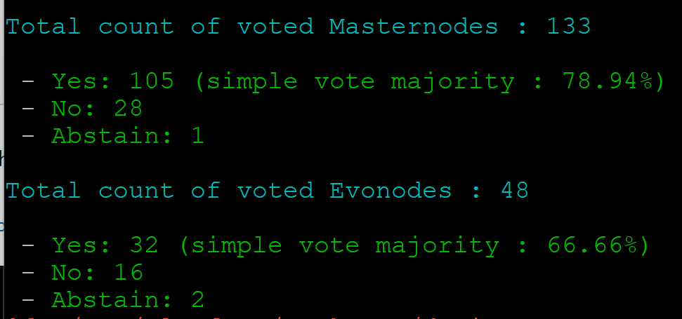

echo -e "${CYAN}Total count of voted Masternodes : $actual_count_masternodes${NC}"
echo
echo -e " - ${GREEN}Yes: $count_yes_masternodes (simple vote majority : $percent_yes_mn%)${NC}"
echo -e " - ${GREEN}No: $count_no_masternodes${NC}"
echo -e " - ${GREEN}Abstain: $count_abstain_masternodes${NC}"
echo
echo -e "${CYAN}Total count of voted Evonodes : $actual_count_evonodes${NC}"
echo
echo -e " - ${GREEN}Yes: $count_yes_evonodes (simple vote majority : $percent_yes_emn%)${NC}"
echo -e " - ${GREEN}No: $count_no_evonodes${NC}"
echo -e " - ${GREEN}Abstain: $count_abstain_evonodes${NC}"
echo

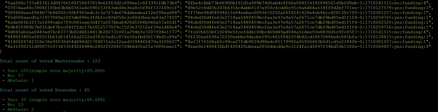

Step 3 : Save as votes.txt
Step 4 : Rename to votes.sh
Step 5 : Transfer this file to your Ubuntu home directory (i use WinSCP for this)
Step 6 : chmod +x votes.sh
Step 7 : dos2unix votes.sh
(if dos2unix not installed, then install through sudo apt-get install dos2unix but on my Ubuntu system it was already installed)
Step 8 : ./votes.sh
'./votes.sh' command can now be used to fetch the votes (yes, no, abstain) of both Masternodes and Evonodes on a specific proposal

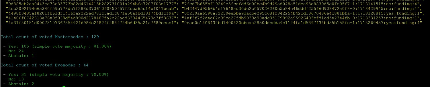

Another update to this script. I am now determining the net yes votes and then taking the percentage of those compared to all that voted, let me know if this is helpful.
Bash:
#!/bin/bash
# Use dash-cli if working, else assume a dashmate is to be used.
if dash-cli -version >/dev/null 2>&1;then
    output=$(dash-cli gobject getcurrentvotes 615d8a6d4edafdcee65ff16ab9c7bacef6f5d1b1096466c0957f0441287dcc90)
else
    output=$(dashmate core cli "gobject getcurrentvotes 615d8a6d4edafdcee65ff16ab9c7bacef6f5d1b1096466c0957f0441287dcc90")

I am not sure i understand QE mentioned 79%, script with simple vote majority calculate 66%
Can you please verify the changes i made in the script in this specific post / comment. By the way : first post still shows your unchanged super majority / yes-no code, i think i will leave that in there for normal budget proposals.
Edit 1 : i suspect it has to do with the abstains getting counted into the 'total count of voted Evonodes' due to [[ $h$i == "funding4" ]] && ((count_evonodes++)). I guess QE only count the yes and no votes into the voting Evonodes, not the abstain votes.

DCG decision proposal 'Evo Accelerated Release Schedule' currently at 65.95% support from Evonodes (a few more Evonode owners voted no recently, see post 1). Could get interesting coming days untill end of voting period (6 days from now).

Here is the latest tally.

** i am providing users a choice now on first post, between using code to fetch votes for a budget proposal and code to fetch votes for a DCG decision proposal.**
I assume the #calculate percentages needs to be changed here as well, maybe to :
Bash:
net_yes_emn=$((count_yes_evonodes-count_no_evonodes))
percent_yes_emn=$(printf '%.2f' $(bc<<<"scale=4;$net_yes_emn/$count_evonodes*100"))

See post 1 screenshots (just know the screenshots still have Evonode votes instead of Evonodes votes, i was too lazy to make new screenshots for that)
