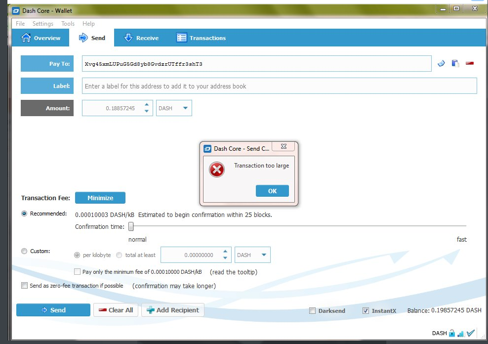

I have made a couple of attempts to send. Have changed the fees, still doesn't send. Now says amount too large. Please see attachment.
Can you exclude the InstantX please and send again? You probably do not have coins to do the IX transaction as it takes 0.01 additional fee. You have the lack of 0.00000003 to send as you wanted.

Yes it is true look:
total balance = 0.19857245
tx fee = 0.00010003
IX tx fee = 0.01
so, 0,19857245 - 0.18857245 - 0.00010003 - 0.01 = -0,00010003
You are short for a tx fee, so to empty your wallet max what you can send is: 0.18847242 dash

0.18847242 still says too large. Should I be checking any boxes?
Uncheck IX box and send lower amount. e.g. 0,198
Please use coin control you can switch on in otpions/preferences wallet labbel.....
you`ll have the exact amount you can send from your wallet whn you check all the inputs.

I'm down to 0.17000000, still not sending.
LOL! that is strange....check my PM please...
