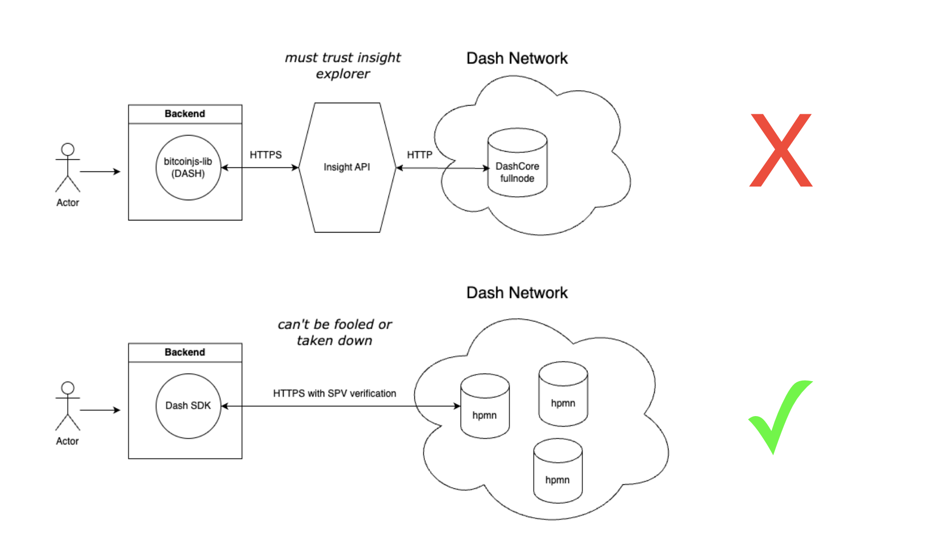

Hey guys, I would like to propose a feature that will enable Dash SDK SPV wallet to be enabled in the mainnet. That will unblock further app development and will ease the onboarding of new devs that wants to integrate Dash in their products. I often see how people want to use Dash SDK in the mainnet, but it's only working in the testnet, however we already have all the infrastructure for that. That will also look like a little step towards our eventual Dash Platform release.
Background
Dash Core Group have already developed a wonderful Dash SDK for Javascript and it gives you much much easier access to the Dash network. It includes everything a regular developer would ever need: SPV wallet, HD keys, and many more. It is originally meant to be enabled together with platform, because it relies on the DAPI to receive block headers and other on-chain data.
DAPI stands for Decentralized API and it is a part of the upcoming Dash Platform system. It acts as a GRPC / JSONRPC gateway for applications to send and retrieve data in the both L1 and L2 protocols.
SPV stands for simple payment verification and it works via checking wallet's transactions in the block headers without downloading and storing them locally. Thus, it makes easier to integrate Dash into different products, because you don't need an external server or hard drive, and you still can verify the incoming data. Integrating Dash is easy as just downloading the library.
Not only that, it is a part of the DashPay vision as well, because it will enable further web extensions development. That extensions expected to look like a metamask in the ethereum's web3. But instead of relying on the centralised API (like etherscan), that can easily fool you and be offline, dash extension will only rely on the Dash Network iteself, means you can't just shut it down.

Technically, it is already possible today to start deploying DAPI components on the HPMN hosts. If I'm not mistaken, network has already activated HPMN nodes and they are incentivised to keep services running. They will provide necessary data for Dash SDK in order for correct so called sync. The task itself is not so big, and its more about network agreement. The approximate things to change:
* Disable platform queries in the DAPI software for mainnet
* Enable DAPI service for mainnet in the dashmate, DMT, DMZ, or any other node deployment tool
* Enable DashSDK for mainnet

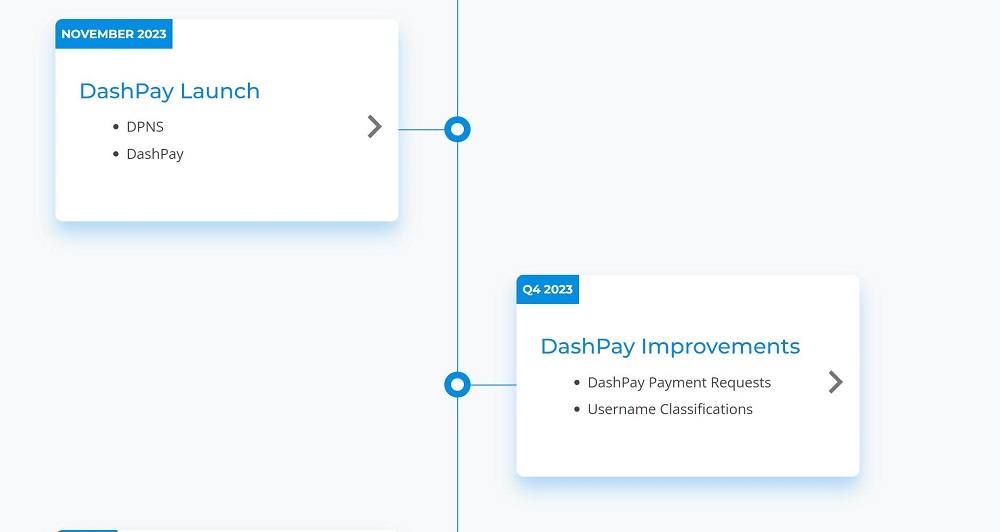

Dash SDK wallet = Dashpay wallet on the Dash Roadmap
The Dashpay wallet at the start was suppose to be a full fledged dapp, something seperate from the Dash mobile wallets (Android, iOS).
However many years ago the decision was made by devs to upgrade existing mobile wallets to ultimately form the Dashpay wallet, and they released already many updates to the mobile apps to lay the foundation for this.
Saying you are against Dash SPV wallet is saying you are against the Dashpay wallet, which has been on Dash Roadmap like forever.
Saying you are against Dash SPV wallet due to not running the full blockchain, is saying you are against Dash mobile wallets.
It makes very little sense to me.
The reason that we can technically implement the Dashpay wallet on Dash Mainnet already is because it does not necessarily need to have Dash Platform active on Mainnet, before getting released (which is also why i consider the Dashpay wallet not a full fletched dapp, i consider it a semi-dapp).
