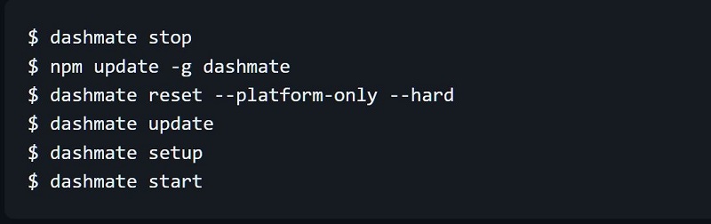

qwizzie@HPMN-Testnet:~$ dashmate stop
qwizzie@HPMN-Testnet:~$ npm update -g dashmate
qwizzie@HPMN-Testnet:~$ dashmate reset --platform-only
Error: Unexpected argument: --platform-only
› See more help with --help

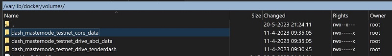

I think this is related to my previous dashmate reset --hard command that should have wiped out the following three folders, but did not actually delete them :
Or maybe it is related to something else. How do i get past this Docker Compose error and start dashmate properly ?

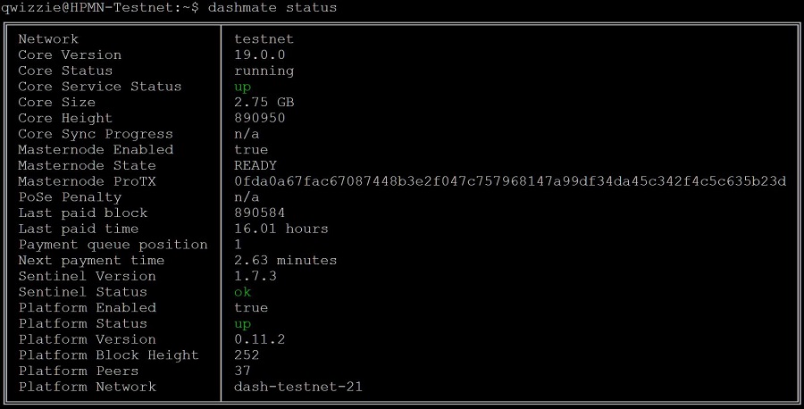

PoSe Penalty n/a : incorrect (should show score 0, hpmn's can still get PoSe scored)
Payment queue position : incorrect
Next payment time : incorrect
By the way, there seems to be a difference between Testnet Setup instructions on Docs (see first pic) and the Github instructions of Dashmate
when doing a dashmate reset command.
Source : https://github.com/dashpay/platform/tree/master/packages/dashmate
Should we be using dashmate reset --platform-only or should we be using dashmate reset --platform-only --hard ?
And should we include a dashmate setup command or not ?
