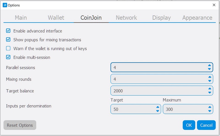

Current Coinjoin settings
It has been awhile since i have done any mixing and i don't have any dash right now to check the mixing proces.

I'm using the latest version of both the Dash Core and Dash Electrum directly downloaded from their sites. The important settings are the same as what you have, although I mixed for 16 rounds in all cases (successful and unsuccessful)
