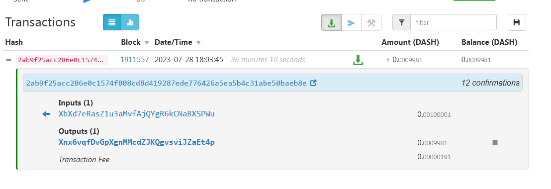

To start, load the core wallet and ideally create a new wallet to play in, goto File and create wallet and give it a name, note you can switch back and forth between wallets from the drop down list on the top right of the Dash Core wallet. In the new wallet, goto the Receive tab and click the button to create the address, copy this address and now switch back to your other wallet, in there find a mixed input of the smallest size and using coin control (you can enable it from the Options menu) send that one input to the new address you just created.
For this guide I am using this address https://chainz.cryptoid.info/dash/address.dws?Xnx6vqfDvGpXgnMMcdZJKQgvsviJZaEt4p.htm

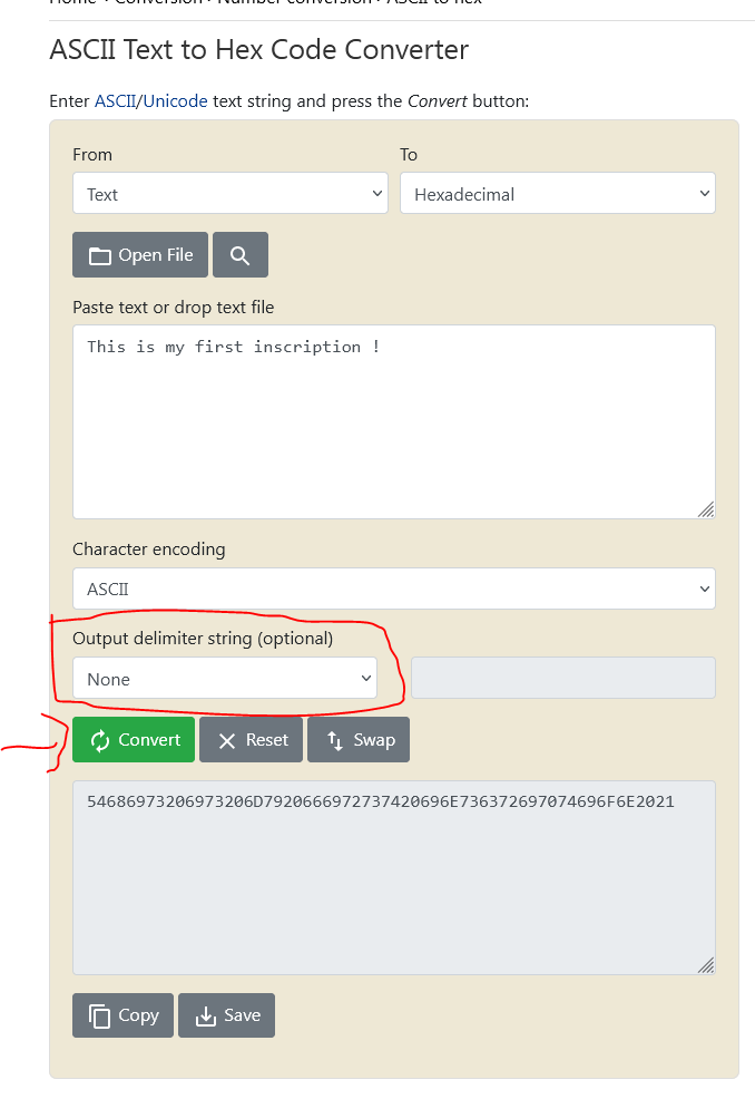

Head on over this site to encode it into hexadecimal. https://www.rapidtables.com/convert/number/ascii-to-hex.html
On the above screen paste in the message and be sure to choose None for the delimiter and then click Convert. Copy the result to notepad.
Go to the transactions tab on the core wallet and right click on the funding TX you did earlier and copy the transaction ID, eg mine is

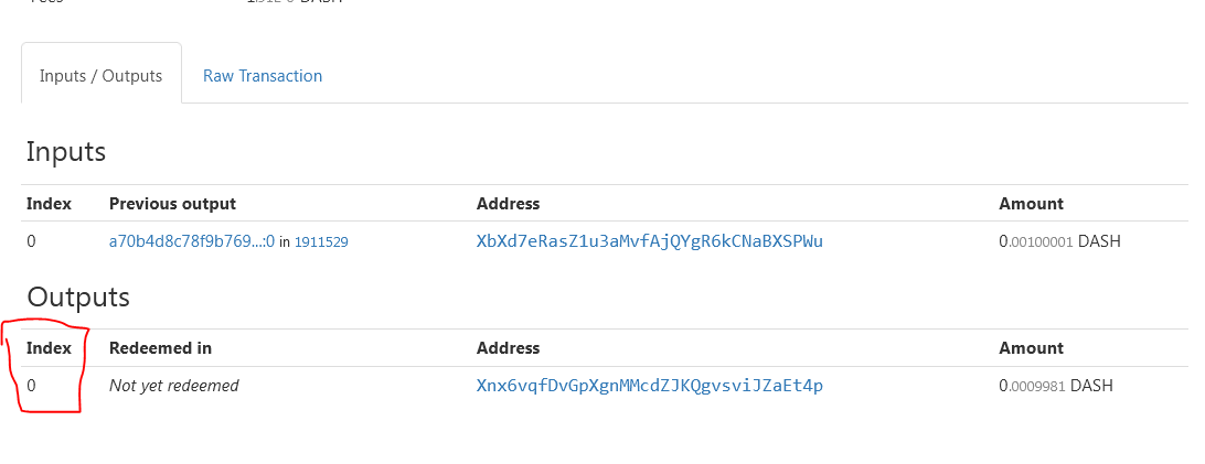

Refer to the explorer, but notice in the below screen grab, the output of the TX is zero, note this down also.

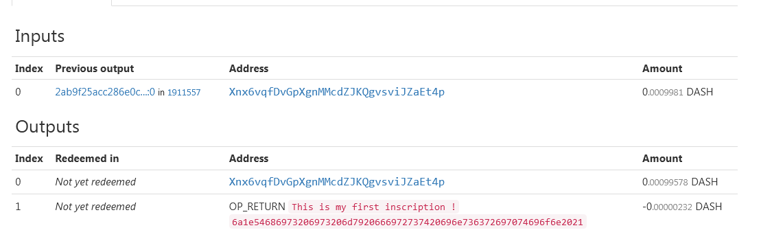

Wait for one confirmation and check the result on the block explorer !
While you are waiting you can check out the site https://mnowatch.org/history/ which finds all of these transactions and lets you search on all of them and read their secret messages! The site updates hourly, so your TX will appear on the explorer before you can see it on the MNOwatch page.
and here it is finally! The completed product! Well done! Now you know how to inscribe any random message you like into the Dash Blockchain !
54686973206973206D7920666972737420696E736372697074696F6E2021
2ab9f25acc286e0c1574f808cd8d419287ede776426a5ea5b4c31abe50baeb8e

5fe19963641d3b1ab0d6b1ef8285eb906356a6404a825897bebcd4f28334adca
