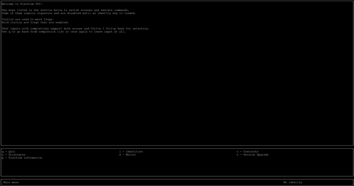

I got a successfull cargo run leading to the start of Platform TUI on Ubuntu 20.04.6 LTS, although with a number of yellow warnings about certain unused imports and a suggestion to apply a cargo fix.
warning: `rs-platform-explorer` (lib) generated 30 warnings (run `cargo fix --lib -p rs-platform-explorer` to apply 9 suggestions)
But before i could do anything, it started Platform TUI.
Should i do that cargo fix to apply 9 suggestions ? (after pressing q)
And did you also receive 30 yellow warnings during cargo run, before it fires up Platform TUI ?

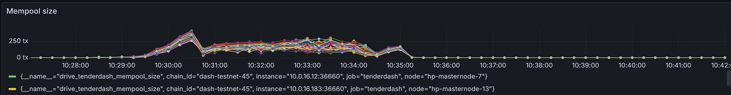

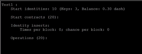

Setting up a strategy test

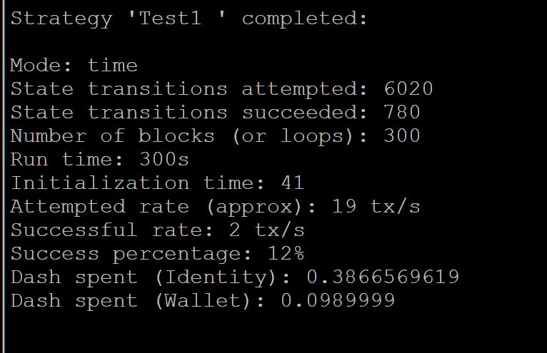

Test1
10 identities with 3 keys each, no transfer key, contracts with 20 variants,1 document per contract, dashpay-variant-5
Outcome : 12% success percentage (had a lot of errors in explorer.log as well). Maybe to do with using dashpay-variant-5 contract ?
Example of error : rs_platform_explorer::backend::strategies: Failed to broadcast transition: DocumentsBatch, Error: Transport(Status { code: InvalidArgument, message: "Identity 5gwt6wPQ7xBR8gthVz4GToTVbywnYEf7gknh7cZ79Ayn is trying to set an invalid identity nonce. The current identity nonce is 0, we are setting 34, error is nonce too far in past", metadata: MetadataMap { headers: {"drive-error-data-bin": "oW9zZXJpYWxpemVkRXJyb3KYJQIRGEUYqhh0FxjdGDwYjBgqGDMYTxg5GKcYuRg5GPYY6xgfGGUYyQgVGMgJGDEY4hjrGJ8YthidGMAYbhiBABgiAg==", "code": "40204", "grpc-accept-encoding": "identity", "grpc-encoding": "identity", "content-type": "application/grpc+proto", "date": "Thu, 09 May 2024 13:09:12 GMT", "x-envoy-upstream-service-time": "14", "server": "envoy"} }, source: None }, Address { ban_count: 0, banned_until: None, uri: https://35.82.49.196:1443/ })

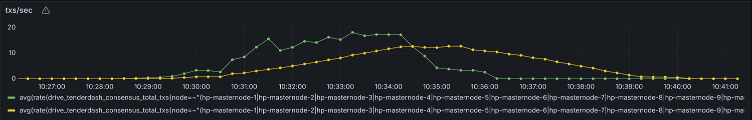

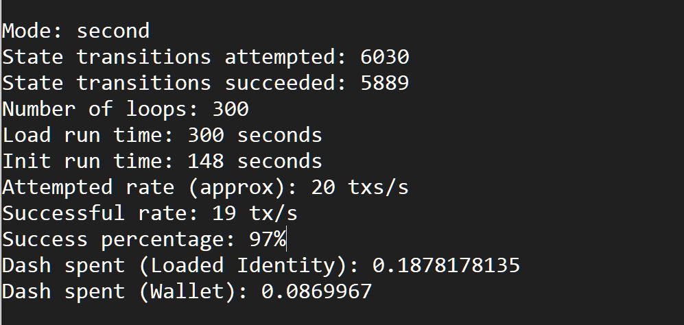

Test2
10 identities with 3 keys each, no transfer key, contracts with 20 variants, 1 document per contract, dashpay-contract-all-mutable
Outcome : 97% success percentage.
@paul_delucia
This Test2 got stuck on screen, just showing 'strategy is running, pls wait'. A previous Test2 had that same problem, but at some point managed to snap out of it, showing the results. This one did not, i got the results 45 minutes later from the explorer.log
Test2 (checking to see if this strategy test would print the results on screen, it does)

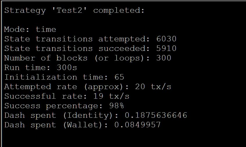

Outcome : 98% success percentage.
Test2
10 identities with 3 keys each, no transfer key, contracts with 20 variants, 1 document per contract, dashpay-variant-5 (the one that previously had such low success percentage of 12%). No problems with having the results printed on screen.

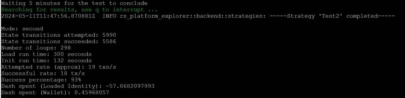

Useful shell script to fetch the final results of a running strategy test (mode : second / time) from the explorer.log directly into another Solar-PuTTY / PuTTY session :
